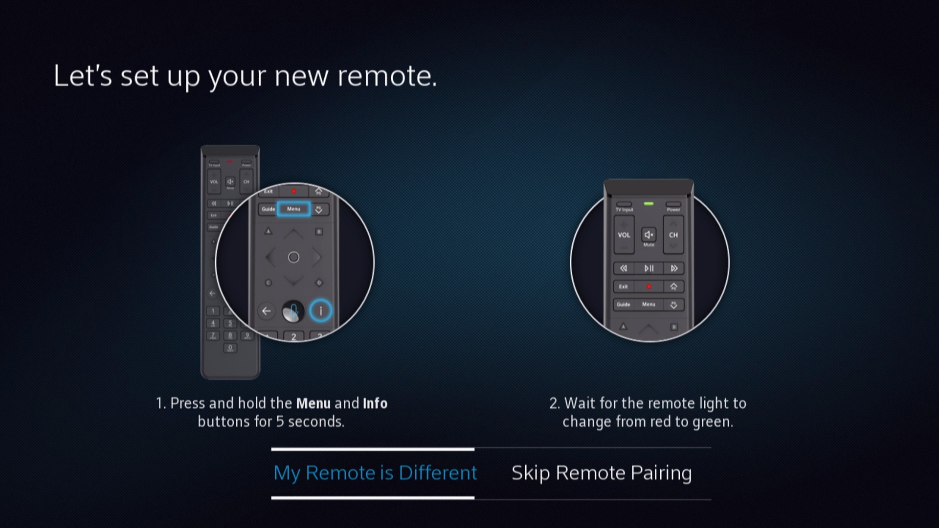

If the voice remote does not pair automatically with the terminal, set it up manually using the on-screen instructions.
Press and hold the Helix and Info buttons until the voice remote’s indicator light changes from red to green. Then enter the three digits that appear on your TV screen.

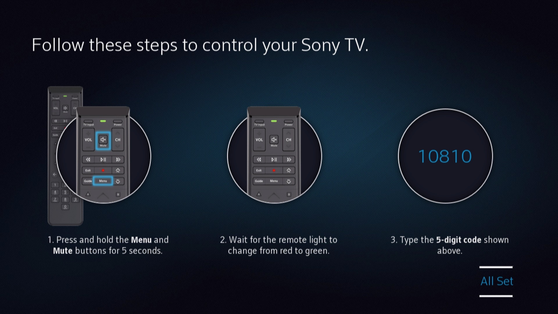

Your Helix voice remote can control your TV, audio receiver, soundbar and home theatre system.
To control your TV with the voice remote, select Yes and follow the on-screen instructions. To ignore this step and proceed to the next one, select No.
If your TV brand isn’t detected automatically, select it from the list or enter its name by selecting the letters using the remote.
Press and hold the Helix and Mute buttons until the voice remote’s indicator light changes from red to green.
auto installation terminal etapes telecommande
Enter the five-digit code that appears on the screen and press OK. Make sure you enter the numbers in order, as they will not appear on the screen.
Check if the remote controls the volume on the TV. If the volume changes, the remote is paired. You can then select It works. If it didn’t pair, select It doesn’t work to repeat these steps with a new code.
